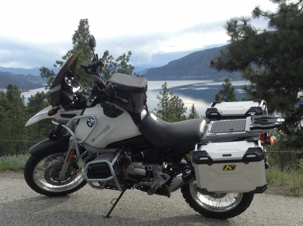

8 years 11 months ago #97
Replied by waynecorley on topic What Did You Do To Your Bike Today?
Wow, you have been busy. I feel like a lazy sloth by comparison. The picture looks awesome and it should look even better on Sunday.

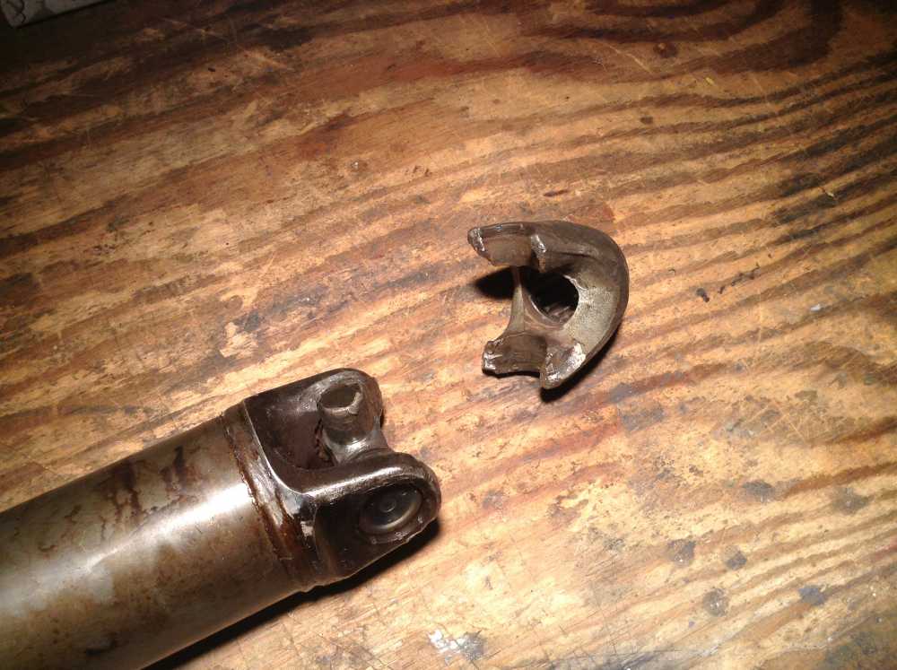

8 years 11 months ago #98
by tskucher
Replied by tskucher on topic What Did You Do To Your Bike Today?
Failed driveshaft u-joint

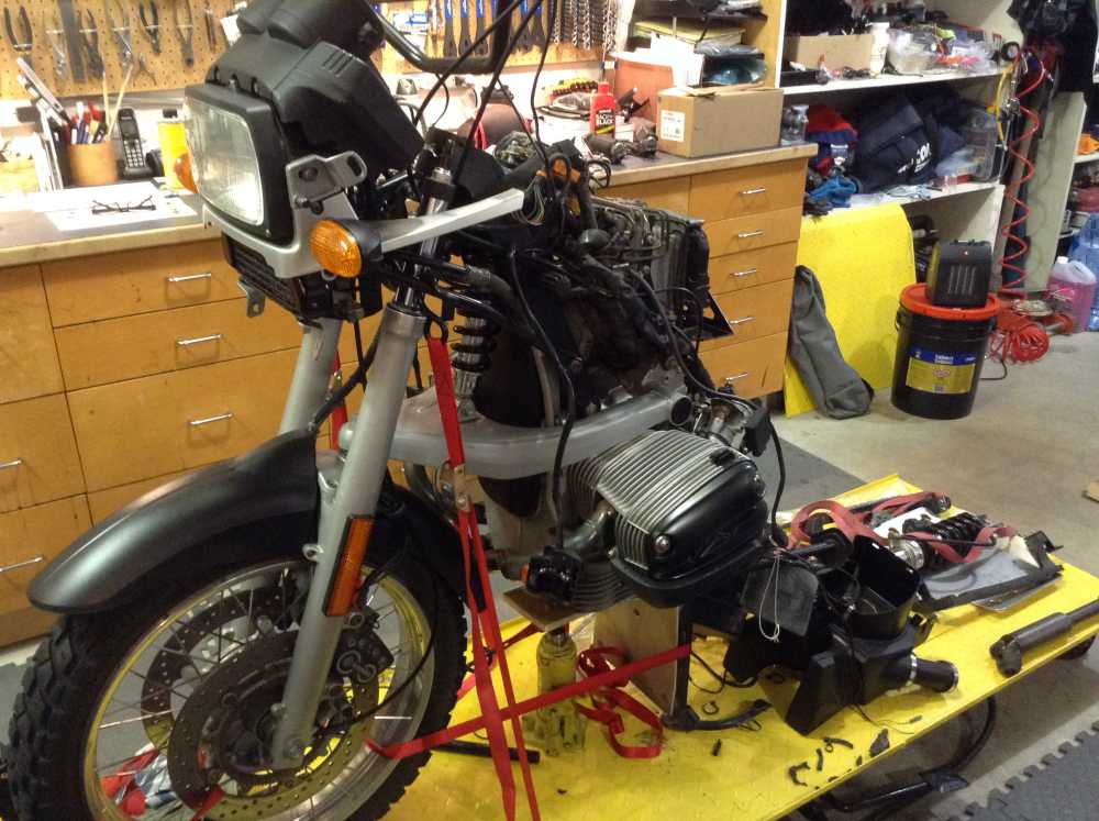

8 years 11 months ago #99
by tskucher
What the bike looked like just a few short weeks ago!
8 years 11 months ago #101
I see what you mean by a "Catastrophic Failure". Did the shaft give you any advance warning? Such as vibration?
tskucher wrote: Failed driveshaft u-joint
