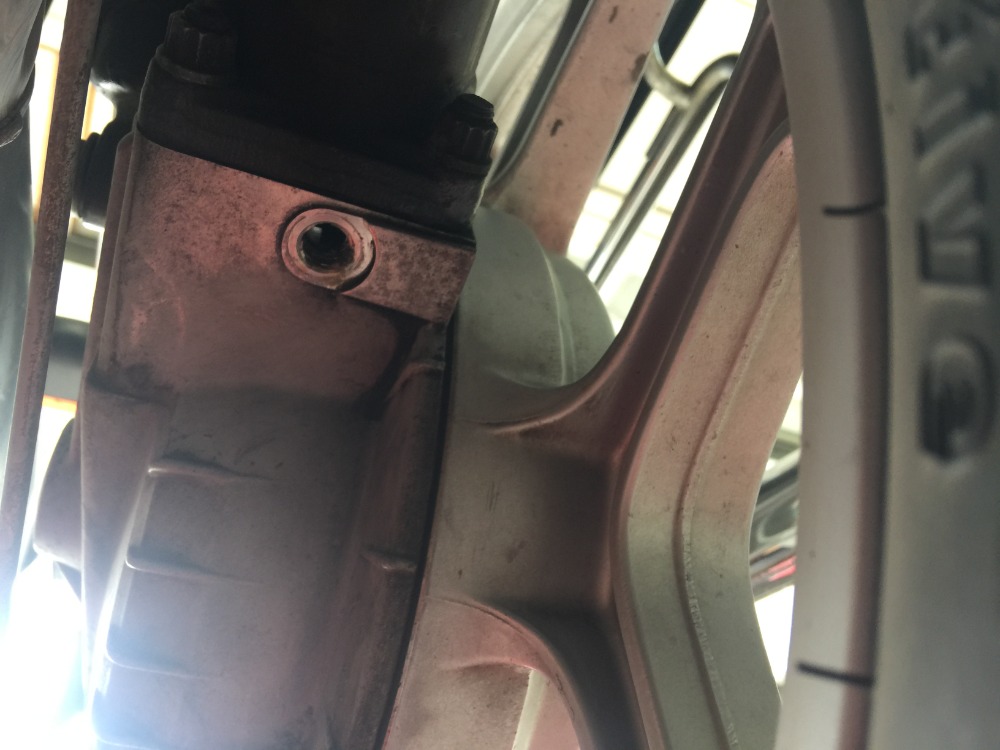

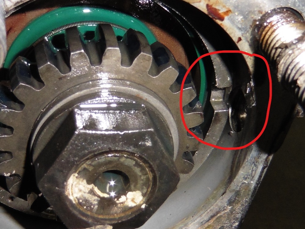

I'm gone a bit backwards on the RT. After Wednesday Breakfast I took a short ride to warm things up so I could change out the Final Drive, Drive Shaft and Transmission Oil. As soon as I touched the Drive Shaft Drain plug I knew I had a problem. The drain hole threads were stripped. Bugger!
I pulled the final drive and sure enough there isn't enough room to drill and tap the hole for a helicoil without removing the pinion gear and the threaded seal holder.
There are two special tools required to remove these two parts. (A third tool if you want the holding fixture for the final drive.) It turns out that Bob H had one of the tools and Kelly F has the other. We've loosened the pinion gear but I'll have to take a run to Falkland to pick up the other tool. In the meantime I'll need to order the drive input seals before I can put it back together so it will be at least a couple of weeks to get this sorted out.
