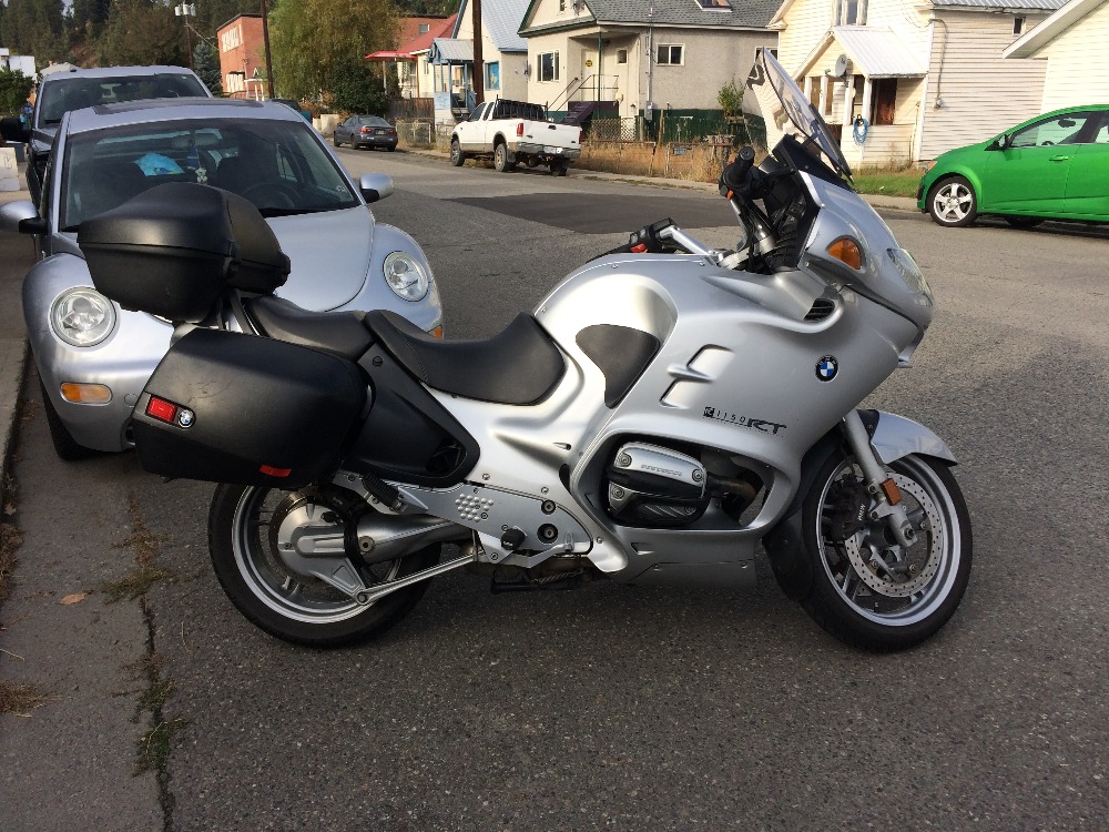

Hello Fellow Riders:
Does anyone out there have experience doing a 2002 R1150RT Spline Lube?
It's due every 65, 000 kms, I believe, and I'm at 115,000 and starting to get concerned.
BTW: I'm NOT a mechanic, so it's probably beyond my VERY basic abilities. Therefore,
I would need to find a NON-BMW Boutique shop to keep the costs down
Any ideas out there?
Tks,
Daniel
