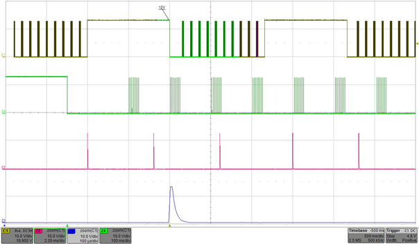

Here is what the handshake looks like.
A ZFE compatible charger sends and repeats a pulse train to the accessory port. The pulse train starts with the charger presenting 12V to the port for 1 second. Then it waits for 150 milliseconds. Next it sends a series of ten 12V pulses each having a duration of 10 microseconds and spaced 100 milliseconds apart. It repeats this pulse train until it senses that the ZFE has connected it to the battery and then it starts its charging procedure.
